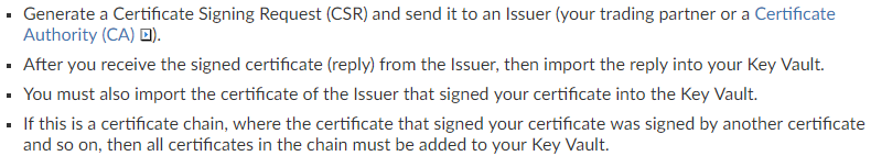

  • b. If your trading partner requires that your certificate is signed by a third party (not self-
    signed), then follow the steps below:
  • c. If your certificate was not signed by a third party (self-signed), then Export your Certificate
    and send it to your trading partner.
