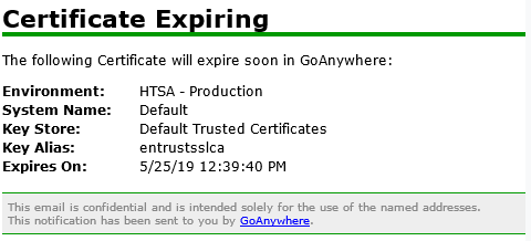

If you have received a certificate expiration warning like the one below, it means a CA Certificate is expiring. This does not mean it is in use, and most likely is not – in which case it can be deleted. If you are not sure, you can export a copy of the certificate first. This will create a backup if you need to import it back in.
As with any CA certificate, it will only affect GoAnywhere MFT transfers if it is actually being used by one of your SSL-enabled listeners, or to build trust for a public certificate that has been provided to you by a trading partner. Its use is unlikely since these are older SHA1 RSA 1024 certs.
CA Cert exp.PNG (10.25 KiB) Viewed 19282 times
