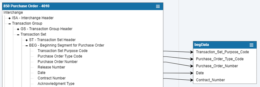

  • When you first launch the EDI X12 Data Mapper, you will see an Input EDI X12 Transaction Set and a RowSet container. The EDI X12 Transaction Set container contains all available data elements, segments, and envelopes for the chosen Transaction Set.
  • Each Transaction Set element can be read to a RowSet variable column. To create a column, select the Transaction Set element then drag and drop it into the RowSet variable container. Double-click on a RowSet container name to give the output RowSet variable a name.
  • Multiple RowSet variables can be created to isolate segments of data. To add a new RowSet, right-click an open space within the Mapper and select Add RowSet. Follow the above drag and drop procedure to populate the new RowSet.

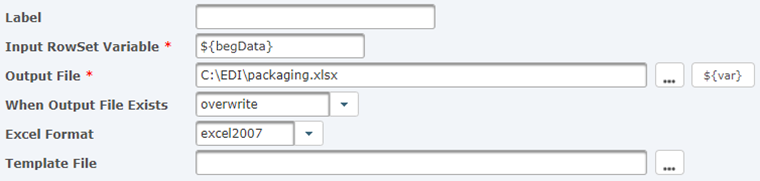

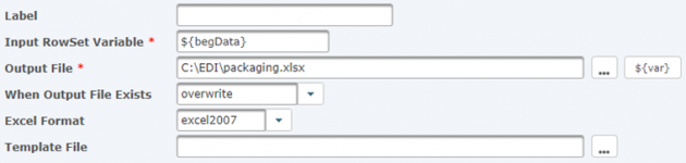

  • One possible use of the output RowSets would be to write the data to an output file. The following image is an example of a RowSet variable containing package data being written to an Excel file using the Write Excel task.
