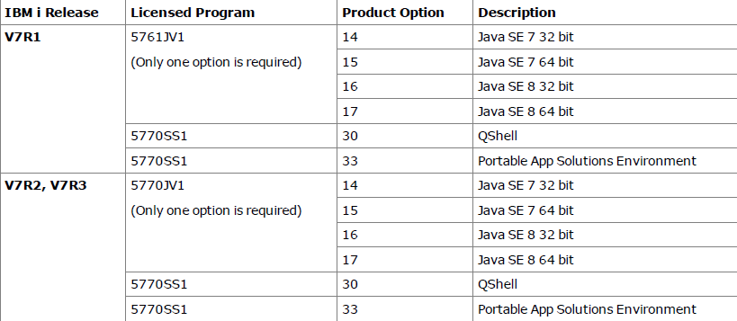

What are the minimum requirements for Java 1.8 on IBMi?
Post by Support_Rick »
Java 1.8 can be run on the IBMi.
Here are the current minimum Licensed Program requirements:
IBMi Requirements.png (27.66 KiB) Viewed 8926 times

This needs to be upgraded for IBM i 7.3 as jdk 6 (option 11) is not supported.
