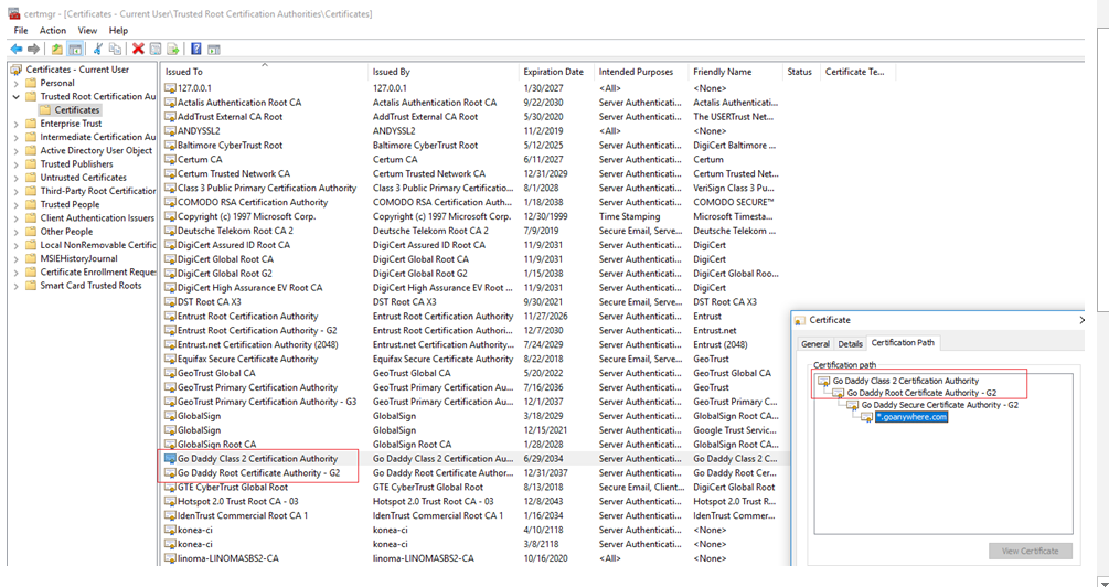

Add the GoDaddy Root cert on the OS level (Windows shown)
Windows > R > certmgr.msc
Confirm that the GoDaddy Class 2 Cert and Root Cert Authority in the Trusted Certs? (pictured below)
The certs of the GoAnywhere site are supplied by GoDaddy. A trust anchor error is tied to the cert chain authority, make sure theOS has the Root certs to validate the https site.
Is certificate already there? If so make sure it is in the trusted key store for GoAnywhere MFT
GoAnywhere version
5.6.0 and higher
Verify it exists in the key vault in MFT. Encryption > Key Management System > System > Manage Certificates
5.5.10 and lower
Verify it exists in the default trusted certificates key store
If it isn’t in one or the other it can be downloaded from the goanywhere.com website. Using Chrome Select F12 > Security View Certificate and then download and place in GoAnywhere and the Windows Cert Manager.
