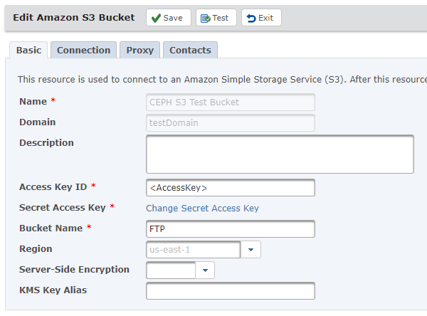

Once you have a working bucket and gateway, copy your keys from the CEPH configuration file into a GoAnywhere S3 Bucket resource.
CEPH S3 Resource.png (25 KiB) Viewed 13191 times

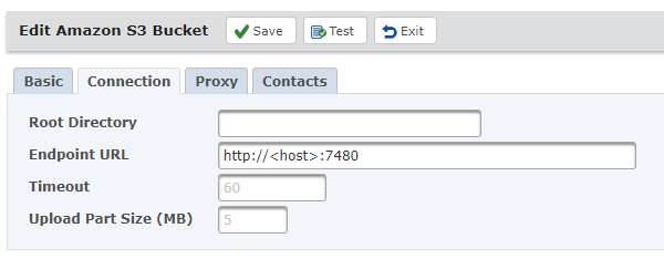

CEPH S3 Resource2.png (12.41 KiB) Viewed 13191 times
Note: RADOSGW does not support HTTPS so some people use a TLS proxy. We recommend bypassing it until you have things working.
Once the resource is defined, you may use the resource within any S3 task as a normal S3 resource.
The connection outlined above was made was using the Bucket-Owner which is seen as bad practice for security reasons. We recommend to create sub-users or IAM users and then copy their keys into the resource.
