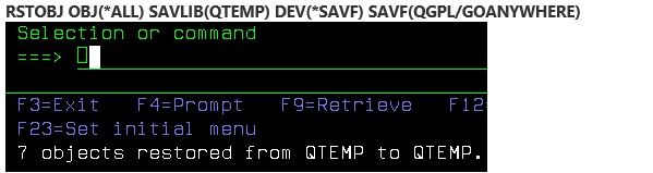

When installing GoAnywhere to an Iseries the INSTALLGA command is run from the QTEMP Library.

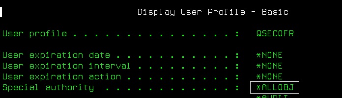

This will not execute if the user profile does not have ALLOBJ authority as specified in step 1 of the instructions. This may also happen if the wrong library is selected. (Message will be slightly different)
Verify the USRPRF does indeed have *ALLOBJ authority
If the user does have authority verify that the RSTOBJ Command did complete in the step prior.
