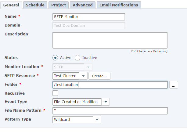

You will see this behavior if the folder you are trying to monitor does not exist on the monitored location. In the snippet below, the SFTP server that is being monitored does not have a directory called 'testLocation'
After updating the folder location to a folder path that is valid on the monitored server, the monitor imported successfully.
