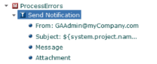

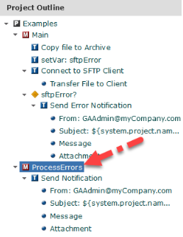

First, create a new module (Project > Module) and give it a unique name.

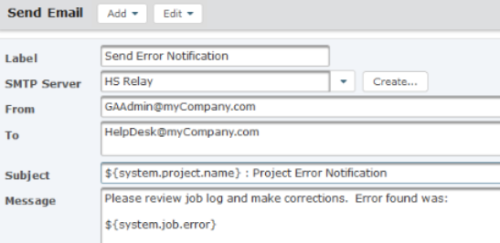

Next, create a Send Email task (Email & SMS > Send Email) within this module.

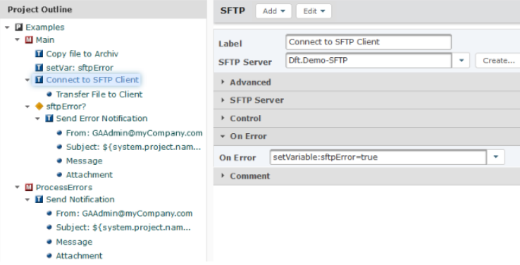

Finally, under the specified task to check for errors, select the "call:[module]" option within the "On Error" panel, where [module] will be changed to the name of the module containing the Send Email task.
